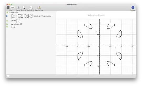

Edit 2: For those curious how I was able to create a recurrence relation in Grapher, here is a screenshot that demonstrates the main idea:

    @MattD How exactly did you create a recurrence relation in Grapher? – Franklin Pezzuti Dyer Feb 26 '18 at 23:46
  • @Frpzzd I've attached a screenshot to my post that demonstrates how it can be done. (The use of separate variables for "start" and "iterations" are optional... those can be included in the equation itself. Also, I messed around in the Inspector to remove the lines between the points.) – Matt D Feb 27 '18 at 18:25

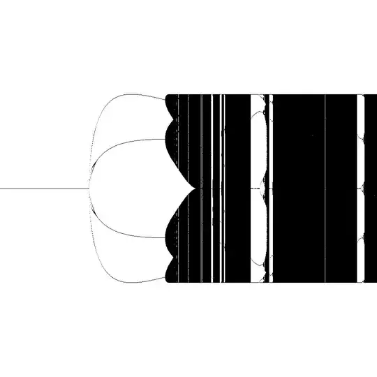

As far as I know, there's no hard-and-fast definition of a "true chaotic map". But there are certainly some that everybody agrees are chaotic - for example, the logistic map, with its famous bifurcation diagram.
For your map, I went ahead and generated a bifurcation diagram for the $x$-coordinates - specifically, in this graph, $k$ is along the horizontal axis, ranging from $0$ to $3$. For each value of $k$, I skipped the first $10000$ iterations, then plotted the next $10000$ $x_n$ along the vertical axis.
Bifurcation diagram
Those solid-black patches are chaos - even after $10000$ iterations, the $x$-coordinates were roughly evenly distributed across the interval $[0,1]$. But see those patches in the middle, where there are only a few points? Those are patches of stability, just like in the logistic map. That sort of behavior I'd call definitely chaotic.
One interesting difference from the logistic map is that it looks like it degenerates into chaos very quickly, with none or virtually none of the period-doubling characteristic of the logistic map. Or possibly the period-doubling is happening, but too fast to be seen on this scale.

  • The final image in my post (the one used to explain how I created recurrence relations in Grapher) contains an image of those symmetrical ring arrangements that arise at the boundary of chaos, btw... an interesting feature of this map. – Matt D Mar 03 '18 at 02:05
