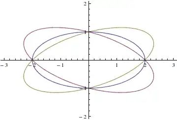

I interpreted the question as asking for intuition about the parameters directly. So here is an alternative explanation. Of course, for doing anything useful with the ellipse, the eigenvalue/eigenvector perspective in Robert's answer is usually the most valuable, as it is coordinate-independent and more mathematically natural.
The ellipse is centered at the point $(h,k)$. It passes through the four points $(h\pm a,k)$ and $(h,k\pm c)$, where $a = 1/\sqrt A$ and $c = 1/\sqrt C$. That is, $A$ and $C$ tell you where the ellipse meets the horizontal and vertical lines through its center.
It's hard to say anything quantitative about the effect of $B$ without involving eigenvalues and eigenvectors, as in Robert's answer. Qualitatively, it controls how the ellipse deviates from being axis-aligned.
Above are three ellipses, each with $A=1/4$ and $C=1$, and with varying values of $B$. As you can see, all of them have the same span along the horizontal axis, $a = 1/\sqrt{1/4} = 2$, and similarly in the vertical, $c = 1/\sqrt 1 = 1$. When $B = 0$ (blue), the ellipse is axis-aligned. When it is positive ($B = 1/2$, maroon), the ellipse is oriented like a "\"; when it is negative ($B = -1/2$, yellow), it is oriented like a "/".
  • For the blue ellipse, ($ B = 0 $) why does its horizontal axis shorter than the other two ellipses? Is this correct? – Karl Dec 24 '12 at 07:39
  • Yes, the value of $a = 1/\sqrt A$ is not the half-width of the bounding box enclosing the ellipse, it is the point where the ellipse meets the horizontal axis. Observe that all three ellipses meet the horizontal axis $y=0$ at the same point. –  Dec 24 '12 at 07:42
  • I've edited the image; maybe this makes it clearer. –  Dec 24 '12 at 07:45
  • +1 (to Robert also). With a little bit of imagination one can `see' here that when $B\to-1+$ or $B\to1-$ (keeping $A,C$ fixed) the ellipse becomes more and more elongated and in a sense approach the union of two parallel lines. – Jyrki Lahtonen Dec 24 '12 at 10:37

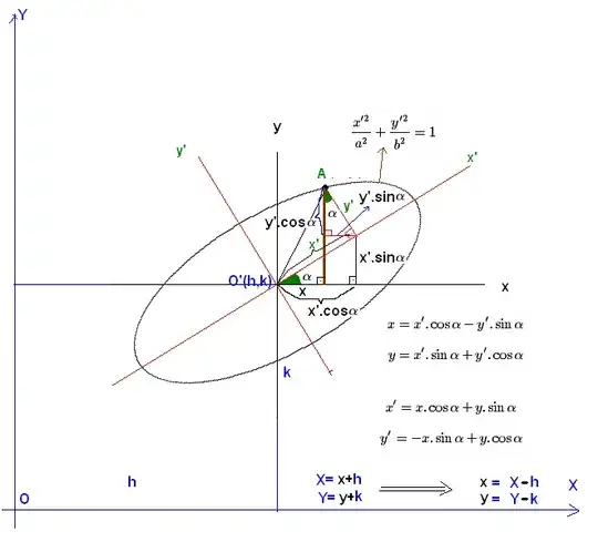

I would like to explain the transforms on a picture.
$$\frac{x'^2}{a^2}+\frac{y'^2}{b^2}=1$$
$$x=x'.\cos \alpha - y'. \sin \alpha $$
$$y=x'.\sin \alpha + y'. \cos \alpha $$
We can get easily the result above from the picture
$$\cos \alpha. x=\cos \alpha (x'.\cos \alpha - y'. \sin \alpha) $$
$$\sin \alpha. y=\sin \alpha (x'.\sin \alpha + y'. \cos \alpha) $$
$$x'=x.\cos \alpha + y. \sin \alpha $$
$$-\sin \alpha. x=\cos \alpha (x'.\cos \alpha - y'. \sin \alpha) $$
$$\cos \alpha. y=\sin \alpha (x'.\sin \alpha + y'. \cos \alpha) $$
$$y'=-x.\sin \alpha + y. \cos \alpha $$
$$\frac{(x.\cos \alpha + y. \sin \alpha)^2}{a^2}+\frac{(-x.\sin \alpha + y. \cos \alpha)^2}{b^2}=1$$
$$(\frac{\cos^2 \alpha }{a^2}+\frac{\sin^2 \alpha }{b^2})x^2+2(\frac{\cos \alpha \sin \alpha }{a^2}-\frac{\cos \alpha \sin \alpha }{b^2})xy+(\frac{\sin^2 \alpha }{a^2}+\frac{\cos^2 \alpha }{b^2})y^2=1$$
$$(\frac{\cos^2 \alpha }{a^2}+\frac{\sin^2 \alpha }{b^2})x^2+ \sin 2\alpha (\frac{1 }{a^2}-\frac{1}{b^2})xy+(\frac{\sin^2 \alpha }{a^2}+\frac{\cos^2 \alpha }{b^2})y^2=1$$
$$Ax^2+ Bxy+Cy^2=1$$
$x=X-h$
$y=Y-k$
$$A(X-h)^2+ B(X-h)(Y-k)+C(Y-k)^2=1$$
$$A=\frac{\cos^2 \alpha }{a^2}+\frac{\sin^2 \alpha }{b^2}$$
$$B=\sin 2\alpha (\frac{1 }{a^2}-\frac{1}{b^2})$$
$$C=\frac{\sin^2 \alpha }{a^2}+\frac{\cos^2 \alpha }{b^2}$$
