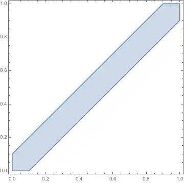

We can solve this without any particularly clever probabilistic insights, just by computing a double integral. First, let's fix $\epsilon$. What's the probability that $a$ and $b$ are at most $\epsilon$ apart? For $\epsilon = 0.1$, it's the area of the shaded region in this diagram:
RegionPlot[Abs[x - y] < 0.1, {x, 0, 1}, {y, 0, 1}]
There are two unshaded triangles which when combined form a square of side length $1-\epsilon$. So the area of the shaded region is $p(\epsilon) = 2\epsilon - \epsilon^2.$ If we pick $\epsilon$ uniformly at random from $[0,1]$, our answer will be $\int_0^1p(\epsilon)\mathrm d \epsilon = \frac23.$
