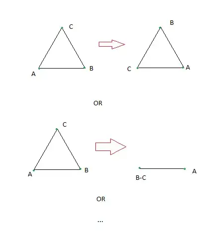

2) Three points A, B, C at the vertices of an equilateral triangle. Every point can jump to one of the others. For instance, A to B, B to C, C to A (three-way swap) or A to B, B to A, C to A (B and C have merged, there are only 2 points now: B-C and A) or etc. The second option is better and, since we are looking for the minimum number of remaining points, for n=3 the answer is 2.
