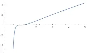

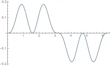

It's easier to be understood in polar coordinates.
(x^2 + y^2 - 1)^3 - x^2*y^3 == 0 /. {x -> r*Cos[\[Theta]],
   y -> r*Sin[\[Theta]]} // FullSimplify
% // ApplySides[#/r^5 &, #] &
$$ \left(r^2-1\right)^3=r^5 \sin ^3(\theta ) \cos ^2(\theta ) \\ \frac{\left(r^2-1\right)^3}{r^5}=\sin ^3(\theta ) \cos ^2(\theta ) $$
Plot[Sin[\[Theta]]^3*Cos[\[Theta]]^2, {\[Theta], 0, 2 Pi}]
Plot[(r^2 - 1)^3/r^5, {r, 0, 5}]
