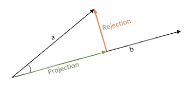

Here's the way that I like to think about it: in $\Bbb R^3$, the dot product is used to give you information about the projection of one vector onto another and the cross product is used to give you information about the rejection of one vector from another.
Dot Product
If we have two vectors $\mathbf a$ and $\mathbf b$, what do we need to specify the projection $\operatorname{proj}_{\mathbf b}\mathbf a$? We need the same things we need to specify any vector: a magnitude (length) and a direction. Geometrically, we see that the magnitude of $\operatorname{proj}_{\mathbf b}\mathbf a$ is $\|\mathbf a\||\cos(\theta)|$ where $\|\mathbf a\|$ is the magnitude of $\mathbf a$ and $\theta$ is the angle between $\mathbf a$ and $\mathbf b$. The absolute value of the cosine is there so that the formula continues to work for obtuse angles (make sure you understand that this formula works for all angles between $0$ and $\pi$ radians).
But what about the direction? By definition, the direction of the projection will either be in the direction of $\mathbf b$ (acute angle) or in the direction of $-\mathbf b$ (obtuse angle). Then note that we don't really need to use a vector to encode this information -- that would be overkill. We could just use a sign ($+$ or $-$) to encode it. Let's say that we want our product to be positive when the angle $\theta$ is acute and negative when $\theta$ is obtuse. I.e. $$\operatorname{proposed operation} = \begin{cases} \|\mathbf a\||\cos(\theta)|, & \theta \in \left[0, \frac{\pi}2\right] \\ -\|\mathbf a\||\cos(\theta)|, & \theta \in \left[\frac{\pi}2, \pi\right]\end{cases}$$ But here's the interesting thing, $\cos(\theta) = |\cos(\theta)|$ when $\theta\in\left[0, \dfrac{\pi}2\right]$ and $\cos(\theta) = -|\cos(\theta)|$ when $\theta\in\left[\dfrac{\pi}2, \pi\right]$. So we can just replace this piecewise defined formula with the simpler $$\operatorname{proposed operation} = \|\mathbf a\|\cos(\theta)$$
So then, we should define the dot product as just $$\mathbf a \cdot \mathbf b = \|\mathbf a\|\cos(\theta)$$ right? Actually, we get two very nice properties if we scale the right hand side (RHS) by the magnitude of $\mathbf b$: $$\mathbf a \cdot \mathbf b = \|\mathbf a\|\|\mathbf b\|\cos(\theta)$$ we get that $\mathbf a\cdot \mathbf b = \mathbf b \cdot \mathbf a$ (easy to see from symmetry of the RHS) and we get that this product is bilinear. That may not make sense to you right now, but it is a very desirable property. And notice that that extra factor doesn't impede our ability to reconstruct the projection at all. In fact, you should confirm for yourself that $$\operatorname{proj}_{\mathbf b}\mathbf a = (\mathbf a \cdot \hat {\mathbf b})\hat {\mathbf b}$$ where $\hat {\mathbf b} = \dfrac{\mathbf b}{\|\mathbf b\|}$.
Cross Product
The construction of the cross product is done very similarly, but the big difference is when we try to encode the directional information. Remember that the rejection of $\mathbf a$ from $\mathbf b$ will be orthogonal (perpendicular) to $\mathbf b$. But in $\Bbb R^3$, there are infinitely many directions orthogonal to $\mathbf b$. So we can't just encode this information in a single scalar -- we'll need the cross product to result in a vector quantity.
If we want any semblance of the symmetry of the dot product, we also can't have the cross product just point in the direction of the rejection because then the direction of $\mathbf a\times \mathbf b$ would have no real relationship to the direction of $\mathbf b \times \mathbf a$. Instead we need a way to encode the directions of both rejections together. Luckily three-dimensional space has a useful property: every plane (containing the origin) is orthogonal to a unique line (containing the origin). So then the clever idea is to construct a plane from $\operatorname{rej}_{\mathbf a}\mathbf b$ and $\operatorname{rej}_{\mathbf b}\mathbf a$ and then point the cross product in one of the two directions along the line orthogonal to that plane. Then we've gotten our choice of infinitely many directions down to just two choices (one of two directions along the line).
Then we just need some way to always make a consistent choice. The right hand rule is a (somewhat arbitrary) way to make such a choice.
One other thing to note (which you could try to prove) is that the plane spanned by $\operatorname{rej}_{\mathbf a}\mathbf b$ and $\operatorname{rej}_{\mathbf b}\mathbf a$ is exactly the same as the plane spanned by just $\mathbf a$ and $\mathbf b$. So when defining the direction of the cross product vector, it's easier to do so in terms of $\mathbf a$ and $\mathbf b$ directly.
Then we can recover the rejection $\operatorname{rej}_{\mathbf b}\mathbf a$ from the slightly more complicated formula (due to the cross product actually being orthogonal to the rejection rather than pointing in its direction): $$\operatorname{rej}_{\mathbf b}\mathbf a = \hat{\mathbf b}\times(\mathbf a\times \hat{\mathbf b})$$ which you can find by first showing that $$\mathbf a \times \mathbf b = \operatorname{rej}_{\mathbf b}\mathbf a \times \mathbf b$$
