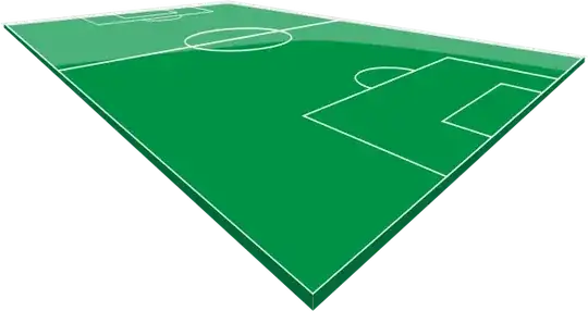

Input example: Input example

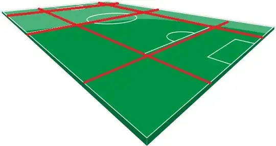

Desired output: enter image description here
(I'm sorry about the drawing, made in Paint but I hope you get the idea behind it)
Any help will be greatly appreciated!
Thank you.
