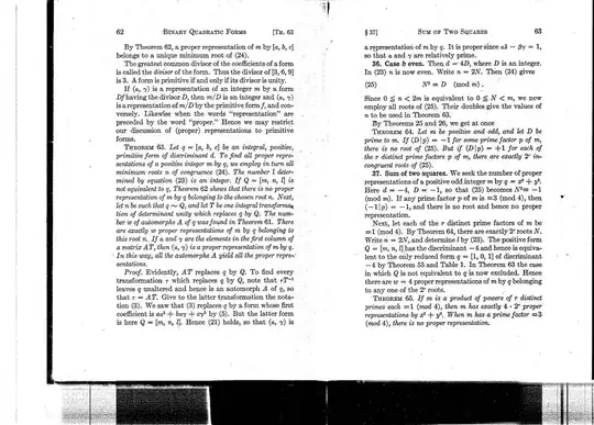

I had to look for a while to find a correct proof that your $d$ is not just the sum of two squares, it is the sum of two coprime squares. Most books will not show how to do this; I am paraphrasing from Modern Elementary Theory of Numbers, by Leonard Eugene Dickson, especially Theorem 65 on page 63. I am going to discuss many things that will require further study.
We can handle the even case separately, so let $d$ be odd and the product of (possibly several) $p^{e_p,}$ where the prime $p \equiv 1 \pmod 4$ and the exponent $e_p \geq 1.$ An induction argument shows that there is an integer $n > 0$ such that $$ n^2 \equiv -1 \pmod d. $$
$$ 4 n^2 \equiv -4 \pmod d, $$ $$ 4 n^2 + 4 = d t$$ with integer $t.$ Actually, as $d$ is odd, we see that $t$ is divisible by $4,$ and we may write $$ 4 n^2 + 4 = 4 d s$$ with integer $s.$ Or, $$ 4 n^2 - 4 d s = -4. $$ This means that the discriminant of the binary quadratic form $$ \langle d, 2n, s \rangle $$ is $-4.$ I should probably add that $ \langle a,b,c \rangle $ means the quadratic form $$ f(x,y) = a x^2 + b x y + c y^2, $$ with discriminant $$ \Delta = b^2 - 4 a c. $$ This means that the form is $SL_2 \mathbb Z$ equivalent ( this is called Gauss reduction) to $ \langle 1,0,1 \rangle. $ Should this be unfamiliar, it means there is an integer matrix $R$ of determinant $1,$ $$ R = \left( \begin{array}{cc} \alpha & \beta \\ \gamma & \delta \end{array} \right) $$ such that $$ R^T H R = I, $$ with $$ H = \left( \begin{array}{cc} d & n \\ n & s \end{array} \right) $$ This means that, taking $$ Q = R^{-1} = \left( \begin{array}{cc} \delta & -\beta \\ -\gamma & \alpha \end{array} \right) $$ we have $$ Q^T Q = H $$ with $\gcd(\gamma, \delta) = 1.$ And, you see, $$ \gamma^2 + \delta^2 = d. $$
The even case is just $2d = (\gamma + \delta)^2 + (\gamma - \delta)^2,$ where both numbers are odd.
