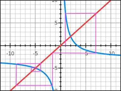

When you have a sequence of the form $a_{n+1}=f(a_n)$ that apparently does not lead to a closed formula for $a_n$, then you have to study the function $f(x)$.
When you graph the curve $y=f(x)=\dfrac{10}x-3$ in blue and $y=x$ in red, you notice there are two intersection points.
These are called fixed points of $f$ since $f(x)=x$. Once solved this gives $x=2$ or $x=-5$.
If the sequence would converge to $\ell$, the continuity of $a_{n+1}=f(a_n)$ will lead to $f(\ell)=\ell$ so $\ell$ will be one of the two fixed points.
On the graph we can see that $2$ is a repulsive point, and $-5$ an attractive point.
Since we are not required to do the full study for all initial seeds fo the sequence, but only for $a_1=10$, we will focus on showing it converges to $-5$.
We can see that the convergence is not a staircase (monotonic convergence) but a spiral. This means we have to show that $a_{2n}$ and $a_{2n+1}$ are both monotonic but of opposite direction.
