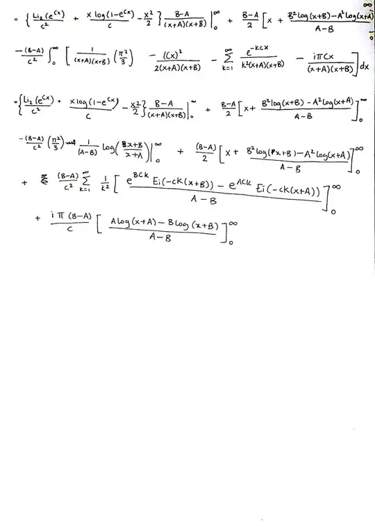

Update: So I ran the calculation with the negative denominator, and used the expansion as explained in the link above, and I've stumbled across a red flag. If anyone is able to explain it I'd be really grateful!
\begin{equation} \begin{aligned}(*) =& \left.\left\{\frac{\text{Li}_2(e^{Cx}}{C^2} + \frac{x\log(1-e^{Cx})}{C}-\frac{x^2}{2}\right\}\frac{B-A}{(x+A)(x+B)}\right|^\infty_0 + 2\frac{B-A}{2}\left[x+ \frac{B^2 \log(x+B) - A^2\log(x+A)}{A-B}\right]^\infty_0 \\ &- \left.\frac{B-A}{2}\left(\frac{\pi^2}{3(A-B)}\right)\log\left(\frac{x+B}{x+A}\right)\right|^\infty_0 + \frac{B-A}{C^2}\sum_{k=1}^{\infty}\frac{1}{k^2}\left[\frac{e^{BCk}\text{Ei}(-Ck(x+B)) - e^{ACk}\text{Ei}(-Ck(x+A))}{A-B}\right]^{\infty}_0\\ &+\frac{i\pi (B-A)}{C}\left[\frac{A\log(x+A)-B\log(x+B)}{A-B}\right]^\infty_0 \end{aligned} \end{equation}
The potential red herring is the imaginary term! The integral should be real (considering all the functions are, though I can imagine convergence issues from the denominator and logarithm), so I guess I haven't correctly used the absolute value of the logarithm correctly: I'm attaching hand working if someone can spot the mistake, or justify why there should be such an imaginary term; I'm attaching the working too. Page 1 Page 2

  • Please try and take the time to properly format all the necessary expression in MathJax instead of using a picture. It would improve this very nice question – Yuriy S Apr 10 '18 at 08:19
