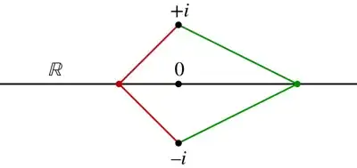

According to the solution of the above problem , the previous statement would imply that $\frac{Z_1}{Z_2}$ is equidistant from $i$ and $-i$. Thus it is real. Now how does that make it real ? Please help me with this.

    If you plot $i$ and $-i$ on coordinate plane it would be $(0,1)$ and $(0,-1)$ respectively. $\frac{Z_1}{Z_2}$ is at equal distance from both these points. So It has to be on X-axis. Hence it has to be real. – MeetR Jan 16 '18 at 17:46

Let $z = \frac{Z_1}{Z_2}\,$, then $|z-i|$ is the distance between point $z$ and point $i$ on the imaginary axis. Likewise, $|z+i|=|z-(-i)|$ is the distance between $z$ and $-i\,$. Therefore, $z$ is at equal distances from $i$ and $-i$, so it lies on the perpendicular bisector of the segment between $i$ and $-i$, which is in fact the real axis.

Hint: The real line is the locus of points that are equidistant from $+i$ and $-i$.
