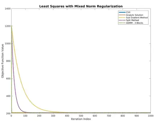

Solving as an Optimization Problem
This section will illustrate 3 different methods to the above problem (Very similar to Elastic Net Regularization).

Results
Code
The code is available (Including validation by CVX) at my StackExchange Mathematics Q2595199 GitHub Repository (Look at the Mathematics\Q2595199 folder).
