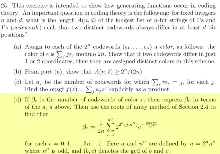

A question from Herbert Wilf's generatingfunctionology book (part (d) of the question):
Question

I am unsure how to proceed from here, or if this approach is even the way to go about it (considering it says to use the 'roots of unity' method). Firstly, I am unsure how to deal with $f(z) = \sum_j a_j z^j = \prod_{k=1} ^{n} (1+z^k)$, especially what to do with the product of $(1+z^k)$ in equation $(3)$.
Thus, I'd like to ask (more preferably hints) help on how to approach this question, or if the working out above is even correct.

Where in $(A1)$ I used the trig identity $\cos^2(x) = \frac{1+\cos(2x)}{2}$. Now, according to the answer, I am hoping there will be a $gcd(k,n)$ in it somewhere.

$$\bbox[5px,border:2px solid #00A000]{\Large \frac{1}{2n} \sum_{j=1}^{n''} e^{-2\pi i rj/n''} 2^{2^a \gcd(j, n'')}.}$$
