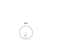

Triangle proof
Another proof I have seen quite often is the triangle proof, cutting the circle into ever thinner concentric rings and unwrapping them to approximate a right triangle:
Again this leaves the question of convergence; do these approximations of right triangles converge to a right triangle of height $r$ and base $2\pi r$? Again it turns out that they do and the argument can be made rigorous, but again to the critical lay person this need not be clear from the picture.

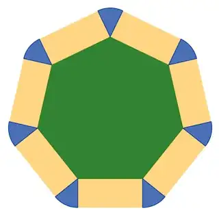

$(\delta)$ also follows from this pictorial argument, where the outer "polygon" is obtained by summing (in the set-sense) a small disk to the inner polygon:
It is visually clear what happens if we let the number of sides go to $+\infty$ while preserving the circum-radii of the inner and outer polygon.

    @Servaes: consider two concentric circles with radii $r,r+\varepsilon$ and a set of orthogonal vectors to the boundary of the inner circle. The area of the annulus exactly equals $\varepsilon L(r) + A(\varepsilon)$. Have you ever seen the proof of the isoperimetric inequality through the Brunn-Minkowski inequality? See pages $111+$ of my notes. – Jack D'Aurizio Jan 05 '18 at 18:36

  • @MikeMathMan: convex boundaries are always well-approximated by polygons, hence yes, it can be used to prove Micheal's premise, too. – Jack D'Aurizio Jan 07 '18 at 20:55
