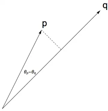

Here is a physicist point of view. A dot product is a projection of one vector onto another. Define each vector in polar coordinates p=p (Cos($\theta_p$),Sin($\theta_p$)) and q=q (Cos($\theta_q$),Sin($\theta_q$)). The dot product gives you p.q=pq (Cos($\theta_p$).Cos($\theta_q$)+Sin($\theta_p$),Sin($\theta_q$))=pq Cos($\theta_p$-$\theta_q$), which depends on the difference angle between the 2 vectors. With a little bit of geometry:
You can see the dot product is the component of vector p along q. In fact, this formula can be generalized to any dimension because you can always define vectors in polar coordinates.
Gwanguy
