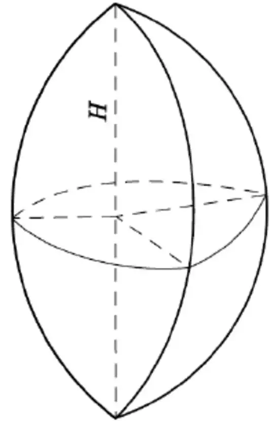

Infinitely many. For example, I think that by taking the intersection of $n $ identical spheres with adequate radius and centres on the vertices of a regular $n $-sided polygon, you create a fair die with $n $ outcomes. An example with 3 sides would look similar to the following:
example with 3 sides [Chkhartishvili, Levan & Suryamurthy, Gokul. (2015). Volume of intersection of six spheres: A special case of practical interest. Nano Studies. 11.]

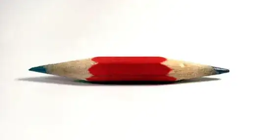

Finally, while all answers (including this one) focus on solids with sides of equal surface, this need not be the case. There can be additional sides with arbitrary surface as long as the die can never land and stay on that side, for example when the projection of the centre of mass falls outside the convex hull of the side. For example a pencil sharpened on both sides: pencil sharpened on both sides (Some symmetry of these "impossible sides" is required so that they do not alter the probabilities of the other sides.)

    Interestingly the last one that you noted is what I immediately thought of. A long regular n-gon prism with short pyramids on the ends such that it can never stable rest on any side of the pyramids is a trivially obvious die with n possible outcomes. I feel it a shame that it is relegated to almost a footnote in your answer since I feel it is much easier to picture how it works than your primary example. – Chris Dec 27 '17 at 15:49
    I guess this is really just a spinning top style dice though really (example picture: https://i.pinimg.com/originals/99/7b/6c/997b6cfc36981a372d7b6a2fb0028eac.jpg ). – Chris Dec 27 '17 at 15:51

    I was about to post the 'pencil' example before seeing this answer. :( +1 – tomasz Dec 28 '17 at 05:33

    @LucaCiti your sphere example kind of looks like an Octahedron with the faces "blown out" a little. – Rohit Pandey Jan 01 '18 at 19:29
