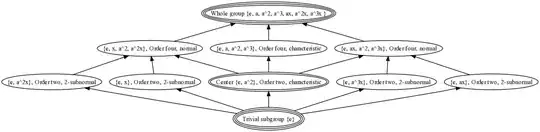

You found the minimal polynomial has degree $4$, so $E / \mathbb{Q}$ has degree $4$. By the fundamental theorem of Galois theory, subfields of $E^{gal}$ contained in $E$ correspond to subgroups of $\text{Aut}(E^{gal})$ containing $\text{Aut}_E (E^{gal})$. $E$ corresponds to a non-normal subgroup of $D_8$ of order $2$ in $D_8$. It's not hard to calculate the subgroup diagram of $D_8$: enter image description here There are 4 non-normal subgroups, and each of these contains only two subgroups of $D_8$- $D_8$, and one of $\{ e, ax, a^2, a^3x \}$ and $\{ e , x ,a^2, a^2 x \}$. Hence $E$ contains $\mathbb{Q}$ and one other subfield. That subfield must be $\mathbb{Q}(\sqrt{2})$.
