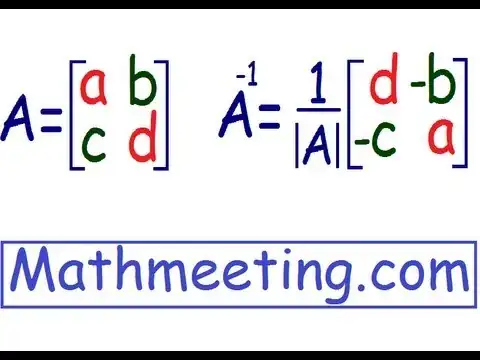

There is a short-cut for finding the inverse of 2x2 matrices
Image of proof
Can someone please explain why it works ? because I can't find any proof ?

The r.h.s. is the adjugate matrix of $A$, i.e. the transpose of the matrix of cofactors of $A$, which is easy to calculate in the case of $2\times2$ matrices.
One proves, independently of the size of the matrix, that $$A\cdot\operatorname{adj}A=(\det A)\,I.$$ This formula is a rewriting of Laplace's formula, and is valid for matrices over any commutative ring.
Bernard
  • 175,478
If an inverse for A exists, it is unique.
Simply multiply out the two matrices; the off-diagonal elements in the result are zero ($-ab+ab$, $cd-cd$). The diagonal elements are both $ad-bc$. Now, recall the determinant is simply $ad-bc$, so when you divide by that the result is the identity matrix.
There really isn't any more to prove here.
This comes from the classical adjoint matrix.
If we have $A = \begin{bmatrix} a & b\\ c & d \end{bmatrix}$, then $A^{-1}=\dfrac{1}{\det(A)}*adj(A)$
Now the $adj(A)= \begin{bmatrix} (-1)^{1+1}d & (-1)^{1+2}c\\ (-1)^{2+1}b & (-1)^{2+2}a \end{bmatrix}^T=\begin{bmatrix} d & -c\\ -b & a \end{bmatrix}^T = \begin{bmatrix} d & -b\\ -c & a \end{bmatrix}$
Now $\det(A)$ is simply $ad-cb$, and so we have that $$A^{-1}=\dfrac{1}{ad-cb}\begin{bmatrix} d & -b\\ -c & a \end{bmatrix}$$
