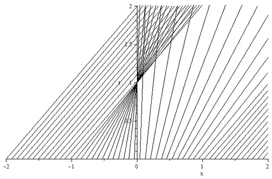

This transport equation is the inviscid Burgers' equation. The figure below represents the characteristic curves in the $x$-$t$ plane:
characteristics
Here, the breaking time where characteristics intersect for the first time is $$ T_b = \frac{-1}{\min_x g'(x)} = 1\, . $$ Indeed, the singularity in $\frac{-x}{1-t}$ occurs at $t=1$.
Now, let us compute the full solution. At $t=1$, characteristics coming from $-1<x<0$ intersect, and should stop at $t=1$. If we consider the position $(x,t)$ in the area $x>0$, $t>1$, we have data coming from $0<x<1$, but no other data. There is no shock wave in this area.
