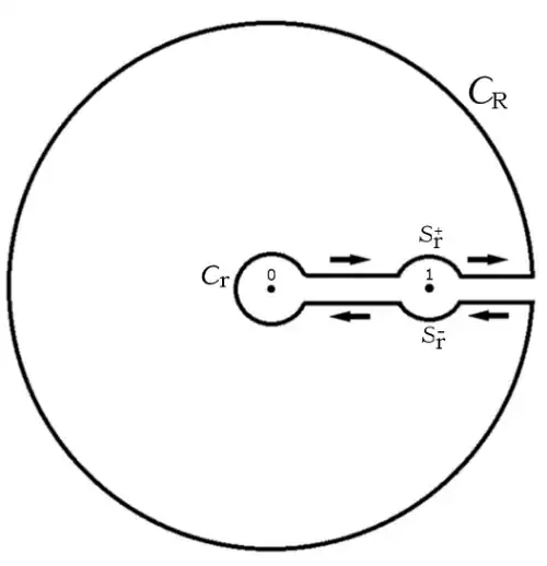

Here is a solution using something akin to the OP's method. We will show that
$$\int_0^\infty \frac{x^a-x^{-a}}{x^2-1}dx = \pi \tan\left(\frac{\pi a}{2}\right)$$
From which the OP's integral is immediate. To do so, we will first evaluate the following integral using complex analysis:
$$\int_0^\infty \frac{x^a}{x^2-1}dx$$
Given $-1 < \text{Re}(a) < 1$ with $a \neq 0$, we let $\Gamma$ be the following contour.
Note that the integrals on $C_r$ and $C_R$ vanish as $r \to 0^+$ and $R \to \infty$ respectively by standard $ML$ estimates. Due to choosing the logarithm to have a branch cut on the positive real line, the $x^a$ in the numerator affects the integral on the positive real line, giving $$\left(\int_R^{1+r} + \int_{1-r}^r\right)f(z)dz = -e^{2\pi ia}\left(\int_r^{1-r} + \int_{1+r}^R\right)f(z)dz\tag{1}$$ By similar reasoning, we find that $$\int_{S_r^-}f(z)dz = e^{2\pi ia}\int_{S_r^+}f(z)dz \tag{2}$$ The integral of $f$ over $S_r^+$ will simply be $$\int_{S_r^+}f(z)dz = -\pi i \operatorname{Res}(1) = - \pi i \lim_{z \to 1} \frac{x^a}{x+1} = \frac{\pi i}{2} \tag{3}$$ Finally, by the residue theorem, the integral of $f$ on $\Gamma$ will simply be $2\pi i \sum \text{Res}(f)$, giving $$\int_\Gamma f(z)dz = 2\pi i \operatorname{Res}(-1) = 2 \pi i \lim_{z \to -1}\frac{e^{a\mathcal{L}_0(z)}}{x-1} = -\pi i e^{a \pi i}\tag{4}$$ Thus, by combining $(1), (2), (3),$ and $(4)$ above, we get $$ (1-e^{2\pi ia})\left(\int_r^{1-r} + \int_{1+r}^R\right)f(z)dz + (1+e^{2\pi ia})\int_{S_r^+}f(z)dz = \int_{\Gamma}f(z)dz $$ So that $$\int_0^\infty \frac{x^a}{x^2-1} = \left(\int_r^{1-r} + \int_{1+r}^R\right)f(z)dz = \frac{\frac{\pi i}{2}(1+e^{2\pi ia})-\pi i e^{a \pi i}}{1-e^{2\pi ia}} = \frac{\pi}{2}\tan\left(\frac{\pi a}{2}\right)$$ Where the last step follows from rearranging the expression into the complex form of $\tan(z)$. Thus we have $$\begin{align} \int_0^\infty \frac{x^a-x^{-a}}{x^2-1}dx &= \int_0^\infty \frac{x^a}{x^2-1}dx - \int_0^\infty \frac{x^{-a}}{x^2-1}dx \\&=\frac{\pi}{2}\tan\left(\frac{\pi a}{2}\right) - \frac{\pi}{2}\tan\left(\frac{-\pi a}{2}\right) \\&= \pi \tan\left(\frac{\pi a}{2}\right) \end{align}$$ Since $tan(z)$ is an odd function. Thus we immediately get the OP's integral by noting $$\begin{align} I&=\int_{-\infty}^{\infty} \frac{\sin(x)}{\sinh(x)}dx \\&= \frac{1}{i}\int_{-\infty}^\infty\frac{e^{ix}-e^{-ix}}{e^x-e^{-x}}dx \\&= \frac{1}{i}\int_0^\infty\frac{x^i-x^{-i}}{x^2-1}dx \\&= \frac{\pi}{i} \tan\left(\frac{\pi i}{2}\right) \\&= \pi \tanh\left(\frac{\pi}{2}\right) \\&\text{As claimed.} \tag*{$\Box$} \end{align}$$
