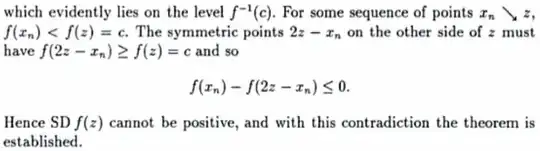

The limit $$SDf(x):=\lim_{h\to 0}\frac{f(x+h)-f(x-h)}{2h},$$ if exists, is called the symmetric derivative of $f$ at $x$. In Brian Thomson's Symmetric Properties of Real Functions, it is shown that
Theorem. A continuous function is necessarily increasing in any interval in which its symmetric derivative exists and is positive.
As a corollary one can deduce that continuous functions with zero symmetric derivatives are constant:
For any $\epsilon>0$, $SD(f(x))=0$ means that $f(x)+\epsilon x$ has a positive symmetric derivative and so, by the theorem, must be increasing; similarly $-f(x)+\epsilon x$ has a positive symmetric derivative and must also be increasing. As $\epsilon>0$ is arbitrary $f$ must be constant as required.
Here is the proof of the theorem in Thomson's book:
We are going to show that the set of points where $f$ is differentiable is dense. Let $(a,b)$ an open interval, since $f$ is continuous on $[a,b]$, it attains its maximal at $x_0$, suppose that $x_0\in (a,b)$
