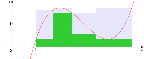

First of all, I would like to show you how we defined Riemann-integrals and Lebesgue-integrals to make sure that we are talking about the same:
Riemann-intregrability
Let $f:\mathbb{R} \rightarrow \mathbb{R}$ be a function.
$$O(Z):=\sum_{k=1}^n(x_k-x_{k-1})\cdot\sup_{x_{k-1}<x<x_k}f(x)$$ $$U(Z):=\sum_{k=1}^n(x_k-x_{k-1})\cdot\inf_{x_{k-1}<x<x_k}f(x)$$
$$\overline{\int_a^b}f(x)\,\mathrm dx:=\inf_ZO(Z) := \inf \{ O(Z) : Z \mbox{ is a segmentation of } [a,b] \}$$ $$\underline{\int_a^b}f(x)\,\mathrm dx:=\sup_ZU(Z):= \sup \{ U(Z) : Z \mbox{ is a segmentation of } [a,b] \}$$
$f$ is called Riemann-integrable over $[a, b] \subset \mathbb{R} :\Leftrightarrow \underline{\int_a^b}f(x)\,\mathrm dx=\overline{\int_a^b}f(x)\,\mathrm dx$
This is the image that we had in mind when we introduced the Riemann-integral:
