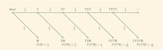

Consider a simpler example: you have a fair coin. You toss the coin over and over and over again. What is the expected number times that you will toss the coin before you get heads? Of course, it is possible that you will toss the coin infinitely many times and never ever get heads. On the other hand, it is also possible that you will get heads on the very first toss. Hopefully, your intuition is that it is extremely unlikely that you will have to toss the coin more than a few times before it comes up heads. We can summarize the whole process with a tree diagram:
The probability at each leaf is the product of all of the probabilities leading up to it (this is a result of independence; note that these kind of diagrams can often be useful for understanding conditioning). On the top row, we just keep tossing tails over and over and over again. The terminal outcomes all end with heads. Then \begin{align} \mathbb{E}[\text{number of tosses}] &= 1\cdot \mathrm{P}(\mathrm{H}) + 2\cdot \mathrm{P}(\mathrm{TH}) + 3\cdot \mathrm{P}(\mathrm{TTH}) + 4\cdot \mathrm{P}(\mathrm{TTTH}) + \dotsb \\ &= \frac{1}{2} + \frac{2}{4} + \frac{3}{8} + \frac{4}{16} + \dotsb \\ &= \sum_{n=1}^{\infty} \frac{n}{2^n} \\ &= 2. \end{align} Hence, on average, we can expect to toss the coin twice.
Notice that we can vastly simplify this picture by noting that if we first toss tails, then we go right back to the start. That gives us this picture:
Then \begin{align} \mathbb{E}[\text{number of tosses}] &= 1\cdot \mathrm{P}(\mathrm{H}) + (1+\mathbb{E}[\text{number of tosses}])\cdot \mathrm{P}(\mathrm{T}) \\ &= \frac{1}{2} + \frac{1+\mathbb{E}[\text{number of tosses}]}{2} \end{align} The $1+\mathbb{E}[\text{number of tosses}]$ comes from the fact that if we toss tails on the first coin toss, then we have already tossed the coin once, but everything else is as though we just started the process from the beginning. This can be phrased in terms of conditional probability, but I don't think that the extra notation will help much here. In any even, solving for the expected number of tosses, we get $$ \frac{1}{2} \mathbb{E}[\text{number of tosses}] = 1 \implies \mathbb{E}[\text{number of tosses}] = 2. $$
