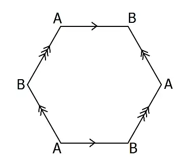

You can use this idea to put a flat metric (in a sense) on any surface obtained by identifying the edges of a polygon in pairs. But the metric won't be smooth unless whenever you have a set of vertices being identified, the angles at those vertices add up to exactly $360^\circ$. It works for the square because you have four $90^\circ$ angles meeting at a point. To see what goes wrong, cut a regular octagon out of a piece of paper, then tear off eight pieces containing the eight vertices and try to tape them all together so that all the vertices meet at a point. You can do it, but you'll get a shape that can't be flattened out without a lot of creasing.
Here's an example of a hexagon that works:
The vertices labeled A are all identified with each other, as are the vertices labeled B. Since the angles all measure $120^\circ$, each set of three angles fits together to make a smooth flat surface. (The resulting surface is homeomorphic to the torus, as it must be because it has a flat metric. It's an interesting exercise to prove this directly by cutting and pasting.)
The reason you can put a smooth hyperbolic metric on a surface of genus $n=2$ or more is that as long as $n\ge 2$, it's possible to find a regular $4n$-sided geodesic polygon in the hyperbolic plane whose angles are all exactly $360^\circ/4n$, so they all fit together to make a smooth surface with a hyperbolic metric.
