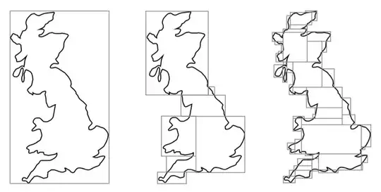

Thinking about area in the context of the Lebesgue measure, I have an intuitive understanding of how area is constructed in $\mathbb{R}^2$:
  • define all rectangles to have the area $length \times width$,
  • the area of a shape in $\mathbb{R}^2$ is the smallest area obtained by covering the shape with rectangles.
In practice, when calculating the area of Great Britain, say, I have following picture in mind.
This process can be made rigorous via measure theory. Indeed it is the unique measure, if rectangles have area $length \times width$ by Carathéodory’s extension theorem.
However this process is limited to area in the plane. How do I think about the surface area of a sphere for example? And can I show that it is consitent with the notion above?
Is there a similar process for finding the surface area of any shape? If not, then how is this done?
