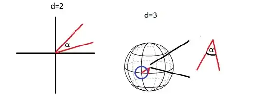

To make it a bit mor cleare I ilusetrate the logic for d=2 and d=3 cases
Now in the d=3 case the blue circle indicates all possible vector which is $\alpha$ away from vector v.
Assume that I am writing a program and I want to call a function such as v = rotateIt(v,direction, alpha). I would expect the function to return the rotated vector. I am having dificulity how to define the direction for any dimension d and also how to rotate the vector towards the given direction with angle alpha. Can anybody give me a solution or direct me to some literature?
