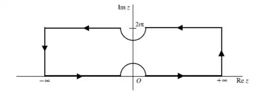

I've seen previous questions around here that show how to do the evaluation via contour integration (Evaluating $\int_{0}^{\infty}\frac{\sin(ax)}{\sinh(x)}dx$ with a rectangular contour and show that $\int_{0}^{\infty}\frac{x\cos ax}{\sinh x}dx=\frac{\pi^2}{4} \operatorname{sech}^2 \left(\frac{a\pi}{2}\right) $) but this particular problem requires that I use the following contour:
I tried applying the previous two methods using this contour, but the final answer I end up with keeps ending up as a completely different form and I am unable to prove that the answer I got is exactly the same as the answers using the different methods linked above.

  • The problem is that the contour used by Thjis only goes up to $R + i\pi$ in the imaginary axis. This problem specifically requires the use of a contour that goes up to $R + i2\pi$ in the imaginary axis, which when I used Thjis's method resulted in a completely different answer – D. Ashton Nov 11 '17 at 00:16

For $I=\int_0^{\infty}\frac{\sin ax}{\sinh x}dx$ and OP's contour above:
The integral on the semi-circle about zero is zero because the residue is zero there, but on the semi-circle about $2\pi i$, the integral is not zero but equal to $-\frac12(2\pi i\,Res_{z=2\pi i}\frac{\sin az}{\sinh z})=-\pi i\sin 2\pi ai$. On the vertical edges the integral tends to zero. Hence, in the limit, $$2(1-\cos 2\pi ai)I-\pi i\sin 2\pi ai=2\pi iRes_{z=\pi i}\frac{\sin az}{\sinh z}=-2\pi i\sin\pi ai$$ and hence $$I=\frac{\pi i\sin 2\pi ai-2\pi i\sin\pi ai}{2(1-\cos 2\pi ai)}=\frac{2\pi i\sin\pi a i(\cos\pi ai-1)}{4\sin^2\pi ai}=-\frac{\pi i}{2}\tan\frac{\pi ai}{2}=\frac\pi2\tanh\frac{\pi a}{2}.$$
