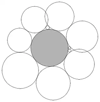

I have a set of circles of arbitrary radii: $r_1, r_2, r_3, ... r_n$.
I wish to arrange them around an inner circle so that they are all touching the perimeter of the inner circle, and do not overlap each other.
What I don't know how to do is figure out the inner radius $r_{inner}$.
I can figure out the angle each circle will use given an inner radius: $\theta_i = 2\sin^{-1} \frac{r_i}{r_i+r_{inner}}$, so I can test whether an inner radius is correct.
My first guess was to solve $2\pi = \sum_i (2\sin^{-1} \frac{r_i}{r_i+r_{inner}})$ for $r_{inner}$, but that's beyond my skills.
I also considered whether the sum of the diameters would equal the circumference of the circle, but that's a set of line segments rather than a smooth arc, and correcting that is also beyond me.
How do I figure out $r_{inner}$?
Numbers of circles around a circle is related, but assumes the circles are identical, which mine are not.

Using the cosine rule, the angle at the centre of the inner circle between lines through the centres of two adjacent touching circles is given by $$ \varphi(i,{i+1}) \;=\; \cos^{-1}\left(\frac{R^2+R r_i+R r_{i+1}-r_i r_{i+1}}{(R+r_i) (R+r_{i+1})}\right) $$ where I've used $R$ instead of $r_{inner}$ for simplicity.
So, we need $$ \qquad\qquad\qquad \qquad\qquad\qquad \sum\limits_{i=1}^n\varphi(i,{i+1})\;=\;2\pi \qquad\qquad\qquad \qquad\qquad\qquad(1) $$ where we consider $r_{n+1}=r_1$.
Using trigonometric identities, for a given $n$, it is possible to convert this into a very complex expression full of square roots, but there seems to be no easy way of solving the result in general (although for $n=3$ and $r_i=1,2,3$, we somewhat surprisingly get $R=\frac{6}{23}$).
Numerical solution is probably the best approach. (The diagram below was generated using Mathematica to solve numerically.)
Moreover, although this is a necessary condition, it is not sufficient in general because a sequence of small circles between two large circles may not fit tightly, causing the solution above to give an incorrect result (with the large circles overlapping):

So for all $i\neq j$, for the above solution to be correct we also need $$ \varphi(i,j) \;\geqslant\; \sum_{k=i}^{j-1}\varphi(k,{k+1}) $$ with appropriate wrapping around of indexes if $i>j$. If this does not hold for some $i$ and $j$, then the correct solution for $R$ is obtained from $(1)$ by discarding circles $i+1,\ldots,j-1$. Due to the possibility of nested overlapping, the testing and discarding needs to be done iteratively, considering increasing values of $|i-j|$ in order.

  • I can imagine situations where the "discard" rule is more complicated. For example, take circles $12345$, where $1$ and $5$ are two large circles flanking two much smaller circles ($2$ and $4$) flanking a single very small circle ($3$). If $234$ are placed "naively" ($2$ tangent to $3$ which is tangent to $4$), then they are close enough together that they allow $1$ and $5$ to overlap, suggesting that the correct answer is found by discarding $234$. But if $3$ is small enough, then $2$ and $4$ overlap, and when this is corrected (by discarding $3$), $234$ can no longer be discarded. – mjqxxxx Dec 12 '12 at 21:07
  • @mjqxxxx: Thanks; I've updated my answer. – David Bevan Dec 13 '12 at 10:02
  • So ultimately it's a matter of solving numerically... Fair enough. I'll test that out and then accept it in the next couple of days. – dja Dec 14 '12 at 02:13
  • Finally got around to implementing it - works beautifully; thank you! – dja Jan 02 '13 at 05:23

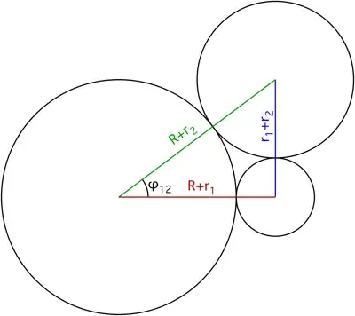

In the following diagram, $R$ is the radius of the center circle and $r_1$ and $r_2$ are two of the surrounding circles.
$\hspace{3cm}$enter image description here
The Law of Cosines says $$ (r_1+r_2)^2=(R+r_1)^2+(R+r_2)^2-2(R+r_1)(R+r_2)\cos(\varphi_{12})\tag{1} $$ which implies that $$ \begin{align} \cos(\varphi_{12}) &=\frac{(R+r_1)^2+(R+r_2)^2-(r_1+r_2)^2}{2(R+r_1)(R+r_2)}\\[6pt] &=\frac{(R+r_1)(R+r_2)-2r_1r_2}{(R+r_1)(R+r_2)}\\[6pt] &=1-2\frac{r_1}{R+r_1}\frac{r_2}{R+r_2}\tag{2} \end{align} $$ We need to find $R$ so that $$ \pi=\sum_{i=1}^n\cos^{-1}\left(1-2\frac{r_i}{R+r_i}\frac{r_{i+1}}{R+r_{i+1}}\right)\tag{3} $$ where $r_{n+1}=r_1$. To this end, define $$ f(x)=\pi-\sum_{i=1}^n\cos^{-1}\left(1-2\frac{r_i}{x+r_i}\frac{r_{i+1}}{x+r_{i+1}}\right)\tag{4} $$ and then $$ f'(x)=\sum_{i=1}^n\frac{\frac1{x+r_i}+\frac1{x+r_{i+1}}} {\sqrt{\frac{x+r_i}{r_i}\frac{x+r_{i+1}}{r_{i+1}}-1}}\tag{5} $$ So we can use Newton's method to get the recursion $$ x_{k+1}=x_k- \frac{\displaystyle\pi-\sum_{i=1}^n\cos^{-1}\left(1-2\frac{r_i}{x_k+r_i}\frac{r_{i+1}}{x_k+r_{i+1}}\right)} {\displaystyle\sum_{i=1}^n\frac{\frac1{x_k+r_i}+\frac1{x_k+r_{i+1}}} {\sqrt{\frac{x_k+r_i}{r_i}\frac{x_k+r_{i+1}}{r_{i+1}}-1}}} $$

  • This seems to be requiring that the angular ranges of the circles don't overlap. I think the intended requirement was only that the circles themselves don't overlap, which doesn't preclude their angular ranges from overlapping. – joriki Dec 12 '12 at 12:16
  • @joriki: I adjusted things – robjohn Dec 12 '12 at 19:19
  • Much better, but you don't mention the problem of large circles overlapping above small circles -- see David's answer. – joriki Dec 12 '12 at 20:16
  • @joriki: nor do I address the issue of whether $R$ changes for differing orders of the outer circles. Soddy's theorem would be useful for detecting the overlaps. I will add something about using Soddy's theorem. – robjohn Dec 12 '12 at 20:26
  • This appears to be very similar to the other answer: apart from different simplification of the angle and some extra solving of Newton's method, is there any real difference between the two? – dja Dec 14 '12 at 02:14
