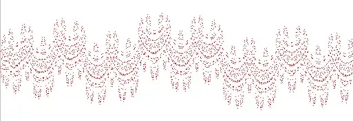

Too big for a comment.
A computational evidence suggests that $S_2(n)=\frac{\varphi^2}{3}n^3-\frac{1}{2}n^2+n I(n)$, where $|I(n)|<3$ and the graph of $I(n)$ looks like that of a Fourier series, see the sample for $1\le n\le 4096$

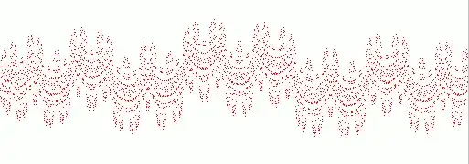

Similraly, $\sum_{k=1}^nk\lfloor k\varphi\rfloor=\frac{\varphi}{3}n^3-cn^2+nJ(n)$, where $c\simeq 0.5590$, $|J(n)|<4.5$ and the graph of $J(n)$ looks like that of a Fourier series, see the sample for $1\le n\le 4096$
