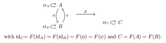

The example is as follows: Consider the following diagram: enter image description here
and take $A$ and $B$ to be objects of category $\mathcal{C}$. Let them be sets where $A$ has 3 elements and $B$ has 2 elements and let $\phi$ send these 3 elements to only one element of $B$ and let $\psi$ send the 2 elements of $B$ to one of the elements of $A$.
Now let $C$ be the object of category $\mathcal{C}_2$, let it also be a set with one element and let the functor $F$ send the objects and arrows as indicated below the diagram.
Is there already an error in this construction? If not, one can show that $F$ is fully faithful and essentially surjective:

Now I do not see which functor could be constructed to show the equivalence because if $G$ sends $C$ to $G(C)=A$, then $G(F(B))=A$ and $A$ is not isomorphic to $B$. The same holds if $G(C)=B=G(F(A))$.

    Hint: There is only one morphisms from $C \to C$, but there are multiple morphisms from $A to A$ (such as $\psi \circ \phi$ which is not the identity). – Pol van Hoften Nov 07 '17 at 19:06
    Ouh...one could consider the composition of $\psi\circ\phi$ as additional maps from $A$ to $A$. Ouh man, thank you, that is it! – exchange Nov 07 '17 at 19:09

Okay, the thing I had not taken into consideration properly was that composition of maps away from an object and back to an object can ultimately be viewed as maps from that object to itself, too.
For example, $\psi\circ\phi$ sends the 3 elements of the set $A$ to a single element of $A$ and is therefore an additional element of $\text{Mor}(A,A)$ which means that the functor $F$ is not faithful anymore because it sends $F(\psi\circ\phi)$ to $F(\psi)\circ F(\phi)=id_{C}$.
As a result, there shouldn't be any equivalence and the example turn out to satisfy the theorem that a functor realises an equivalence iff it is fully faithful and essentially surjective.

A delayed answer, but it is perhaps good to set the record straight on this question. In short: yes, $F$ is an equivalence of categories and $A$ is indeed isomorphic to $B$.
In your answer, you seem to suggest that the morphism $\psi \circ \phi$ is different from $\operatorname{id}_A$. However, I don't think it is: the four arrows are probably the only four morphisms the category has and the composition of $\phi$ with $\psi$ should give the identity on $A$.
With this interpretation of the example, the functor $F$ is both essentially surjective and it is fully faithful, precisely because of the reasons you mention.
This is not a contradiction, because the functor $F$ is indeed an equivalence. There are two choices for an inverse $G$, of which one is the one you gave: $G(C) = A$, $G(\operatorname{id}_C) = \operatorname{id}_A$. As you point out, $G(F(B)) = A$. But note that $A$ is isomorphic to $B$ via $\phi: A \to B$ with inverse $\psi: B \to A$! So $G \circ F$ is naturally equivalent to the identity on the category $\mathcal{C}_1$! Also clearly $F \circ G$ is equal to the identity on $\mathcal{C}_2$, so $G$ is an inverse of $F$ and thus $F$ is an equivalence of categories.
On a final note, let me remark that your definition of essentially surjective is not quite correct. A functor is said to be essentially surjective iff for every object $C$ in $\mathcal{C}_2$, there is an object $A \in \mathcal{C}_1$ such that $F(A)$ is isomorphic to $C$! It is important that $F$ does not have to be strictly surjective on objects! For example, the functor $G: \mathcal{C}_2 \to \mathcal{C}_1$ is essentially surjective, even though it is not surjective.
