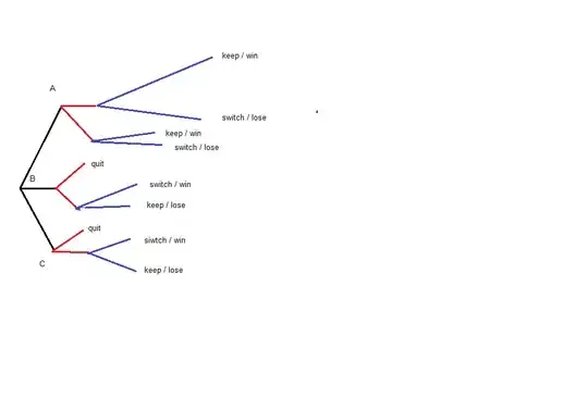

Here is a picture enter image description here
Suppose the car is on card A (you don't know that).
You choose, A,B or C. (the black lines). The host makes the red line choice. You make the final keep or switch choice.
All of the keep/switch choices are equally likely. Half win, half lose.

  • I have given a chart that may be more intuitive. Regarding the notation. There is a 2/3 probability that you have chosen the wrong card. Given that you have chosen the wrong card there is a 1/2 probability that the host reveals a goat. Together they are a probability of (2/3)(1/2) = 1/3. – Doug M Nov 07 '17 at 18:11
  • So like I said if you can write analytically how you arrived at the solution (e.g. how you computed the conditional probabilities etc.), I would appreciate more; since the image does some job but I'd more appreciate analytical solution. e.g. above in comment you say "Together they are a probability of (2/3)(1/2) = 1/3." - so why does that justify that I should not change my choice? –  Nov 07 '17 at 18:51
