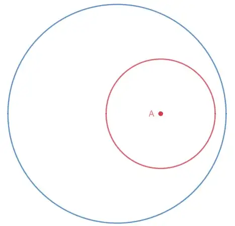

$\large{\mathbf{\text{Area Surrounding $\boldsymbol A$}}}$
In order to define $P_L(u)$, one must find the area of the region $S_A(u)$, which is the intersection of a circle of radius $u$ surrounding $A$ and the dartboard $D$. If $\rho_A+u\le r$, then the circle is completely contained by the dartboard, and the area of $S_A(u)$ is simply $\pi u^2$.
overlapping

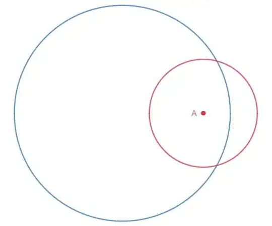

If, however, $\rho_A+u\gt r$, then the region is not a circle.
not overlapping
You can interact with these visuals on Desmos.
This answer includes the formula for calculating the area of the overlapping region
$$X=u^{2}\arccos\left(\frac{\rho_A^{2}+u^{2}-r^{2}}{2\rho_A u}\right) + r^{2}\arccos\left(\frac{\rho_A^{2}+r^{2}-u^{2}}{2\rho_A r}\right) - \frac12 \sqrt{(-\rho_A+u+r)(\rho_A-u+r)(\rho_A+u-r)(\rho_A+u+r)} $$
Hence $$m\bigl(S_A(u)\bigr) = \begin{cases} \pi u^2 & \rho_A\in[0,r-u] \\ X & \rho_A\in(r-u,r) \\ \end{cases}$$
