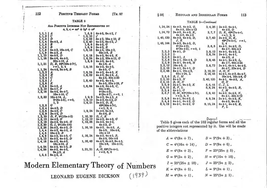

EDDDITTTT: I notice you also asked about the Hilbert norm residue symbol. So the best thing you can do is get CASSELS and look through the first 60 pages. What you do is begin with $$ 2 x^2 + 3 y^2 + 2 z^2 = n $$ and switch to $$ 2 x^2 + 3 y^2 + 2 z^2 - n t^2 = 0. $$ You especially want the table of the symbol on page 43 and the conditions for isotropy on pages 58-59. I have gone through the whole song and dance for an answer here on MSE, I think it was an indefinite form. If I find it I will put in a link. Isotropy over $p$-adic numbers
Anything needed is at TERNARY
