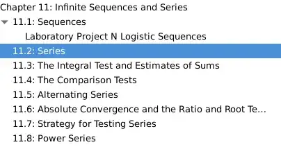

So you know what experience I have and how I should try to justify my answer, here is a picture of the chapter and its sections.
I don't know which section the problem in the title comes from. This is also from a calculus 2 course.
Ok, first, if I take the limit of $$\sum_{n=1}^\infty {1\over n(n+1)(n+2)}$$ I will end up with $0$ correct? Since as n gets bigger the denominator also gets bigger meaning the number gets smaller. I'm not even sure if I need to take the limit. Assuming what I just did is correct, that means the series is convergent to $0$, but how would I justify the answer I get? If you look at the chapter I uploaded, is there a test I can use? I have tried reading all of it but it just isn't making sense to me.
Thank you for any help anyone can give me, If I can see how someone would go about solving this, then I should be able to solve the rest on my own.
