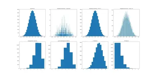

As an experiment, I also wanted to determine for a length 8 sequence (like what I've been using as examples), how much resolution does each measure give us? I.e., how many different distances does each option provide. So I ran all permutations of each of the discussed methods (with some minor modifications described below) and generated this histogram table. One final note of why Kendall Tau could be the overall winner is that you can actually weight the relative position exchanges, giving even more granularity in the distance result (as you'll see in the histograms).
histograms of different permutation distance methods
Kendall Tau is computed via the python, scipy.stats library (as is the Weighted Tau). Note that weighted tau with all 1 weights is the same as traditional tau. The documentation for the weighted function also suggests that, in general, a hyperbolic function for the weights can be preferable. I also show what a linear weighting looks like though (i.e. 1,2,3,4,5,6,7,8 as the weights).
Finally, Transposition Distance is the distance metric described in the original post I linked.
Cycle Rearrangement Distance is the distance metric suggested by David K, allowing for contiguous movements and counting how many moves of contiguous blocks are needed to get to a particular configuration.
L1 Distance is the sum of the absolute value of the subtraction of each element in each list. I.e. sum(|[1,2,3] - [3,2,1]|)=4.
L0 Distance (for lack of a better term) is the method described by Kanak without the extra diagonal.
As you can see from the image, even without the weighting, Kendall Tau gives far more potential distances and has far more resolution than the other methods. Although I can imagine circumstances where the others would be preferred, that is the one I will be going forward with.

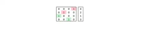

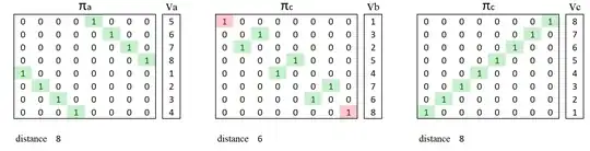

What about involving (some sort of) $\text{L}^1$-norms of permutation matrices?
Let's create $3$ of such matrices, with each corresponding to the three cases a), b) and c), respectively $\pi_a$, $\pi_b$ and $\pi_c$. With $v$ standing for the $8 \times 1$ vector equal to $(1,2,3,4,5,6,7,8)'$, what follows is my suggestion
It considers as distance the sum of off-diagonal $1$s. Like David, "To my eye" the cases $v_c$ "looks like an extreme opposite" of $v$. However, $v_a$ is as far as $v_c$ from $v$. The closest one is $v_b$.
To comply with your intuition about the proximity between $v$ and $v_c$, one may want to drop out from our sum the $1$s being on the ante-diagonal, giving a problematic distance of $0$. That of $v_b$ from $v$ becomes $4$.
Using your first example, the distance that one obtains is $2$.

  • I really like the approach with permutation matrices. It makes the issue of distance feel a bit more concrete. It drops the assumption about contiguous sublists being important, but in exchange it's a fairly straightforward metric.
    Out of curiosity, what did you use to do your visualization? I may want to try something similar when/if I show this method to my colleagues.
    – user986122 Oct 27 '17 at 22:23
    @user986122. Excel, with conditonal formating. – keepAlive Oct 27 '17 at 22:25
