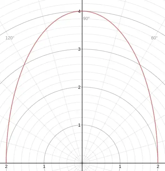

ADDENDUM: Follow this LINK to an adjustable pattern you can use to create a form for bending the pipe. You can change the values of $W$ and $H$. I assume you know how to heat the pipe so it will hold its shape. Using the adjustable diagram you can use a sheet of $4\times8$ plywood and tack a pair of finishing nails at the appropriate distances along the angular grid to create a frame for bending each half of the ellipse. Bend one half and after it has cooled, use the same frame for bending and heating the other half. I am attaching a picture of what the link looks like when $H=W=4.$ At the link above you can change those values.
