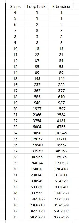

So I went ahead and did the computer simulation to check that the number of loop backs (intersections) continues to match the Fibonacci series and it does....for one more step. Then it deviates for a few steps, then gets back on track in steps $13$ and $14$ and then deviates permanently. See the comparison below:
If one computes the expected number of steps at each step, the "loop backs" surges ahead of the Fibonacci series at step $11$ and only starts falling behind at step $25$. Since we know that the Fibonacci series gives the answer $8$, I think we can conclude that the actual answer to the OP is slightly less than $8$.
