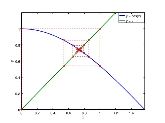

Here's a picture: enter image description here
The blue line is $y=\cos x$, the green line is $y=x$. The red dashed line shows what happens when you repeatedly apply the cosine on an initial starting value, in this case zero. You can see how it converges to the intersection of the two lines, i.e., the point where $x=\cos x$.
Generating the red dashed line
In the image, start from the point $(0,0)$ and follow the dashed line. Moving vertically from $(x,y)$ to $(x,y')$ corresponds to applying $y'\gets\cos x$. Moving horizontally from $(x,y)$ to $(x',y)$ corresponds to applying $x'\gets y$. Starting from $(x_0,y_0)$, the points then follow this sequence ($V$ and $H$ denote moving vertically and horizontally respectively): \begin{align} (x_0,y_0) &\overset{V}{\to} (x_0,\cos x_0)\\ &\overset{H}{\to} (\cos x_0,\cos x_0)\\ &\overset{V}{\to} (\cos x_0, \cos(\cos x_0))\\ &\overset{H}{\to} (\cos(\cos x_0),\cos(\cos x_0))\\ &\overset{V}{\to} (\cos(\cos x_0),\cos(\cos(\cos x_0)))\\ &\overset{H}{\to} \cdots \end{align}
