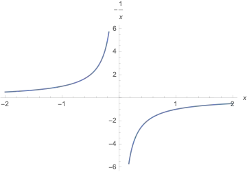

A physics related example may also be useful. Consider a potential of the form $V=-Log(\left|x\right|)$. Then the force is given by $$ F=-{d V \over d x}={1\over x}. $$ The work done on a particle which moves from $-a$ to $a$ (where $a>0$) is $$ W=\int_{-a}^a{1\over x} dx. $$ From conservation of energy, we would expect $W=0$ as $V(a)=V(-a)$ and so, in that case, the Cauchy principal value gives the correct answer. However, in general, we would expect that it is not physically possible to have an infinite potential and so some new physics would come in near to $x=0$ which would change the shape of the potential in that region. But, provided that energy is still conserved we would still get $W=0$ when moving the particle from $-a$ to $a$ and so the Cauchy principle value would still have given the correct answer even without accounting directly for the new physics.

I like Abhimanyu Pallavi Sudhir answer: we can assign the integral $\int_{-1}^1\tfrac1x\,dx$ the value $\infty$, $-\infty$ or any other number, and we would be equally right. There is no criterion to select a result over the other. Sometimes this is presented as a flaw of the Lebesgue integral, which I think is nonsense; this integral just does not have an unambiguous meaning and it is not the fault of Lebesgue or of Riemann.
If, however, we consider the integral operator $$ T(f):=\int_{-1}^1 \frac{f(x)}{x}\, dx, $$ where $f$ is an arbitrary smooth function, then things are different. Let us develop $f$ in a Taylor series; we get, formally, $$ \int_{-1}^1 \frac{f(x)}{x}\, dx = f(0)\int_{-1}^1\frac{dx}{x} + f'(0)\int_{-1}^1\, dx + \ldots$$ The only ambiguous term is the zeroeth-order one; all the others make perfectly sense as standard integrals.
Conclusion. We need a renormalization procedure that removes the zeroeth-order term. This procedure amounts to exploit symmetry, prescribing that $\int_{-1}^1 \frac{1}{x}\, dx$ should be interpreted as $$ \lim_{\epsilon \to 0}\int_{\epsilon<\lvert x \rvert <1} \frac{dx}{x}=0,$$ that is, considering integrals in the principal value sense.
