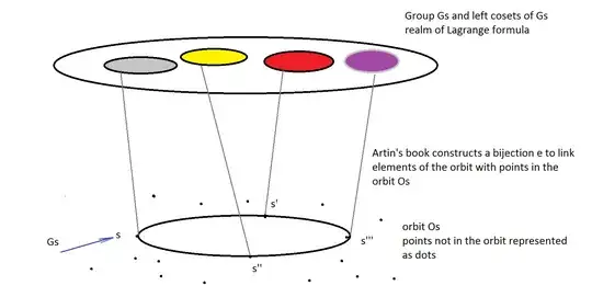

Artin's proof
In the standard algebra text by Artin, the proof is based on bijection function $\epsilon$ that links each point in the orbit to some left coset of stabilier, $Gs$. So we can use Lagrange formula. The scheme is this. enter image description here
We see the orbit (part below), construct the bijection function to link its elements to left cosets of the stabilizer (part above) to be able to use the Lagrange formula. Full stop.

Because we proved Lagrange formula algebraically, and constructed bijection algebraically, we have to play with this picture to convince ourselves this indeed OK.

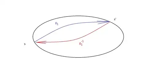

First, inverse action group elements of Stabilizer also fix $s$. Put $gs=s$. Then $gs=(g g^{-1})s$ and $s=g^{-1} s$. This means if $g_1$ maps $s \to s'$ then this $g_1$ cannot be in the stabilizer of $s'$. For each point in the orbit he number of elements in its stabilizer is the same. enter image description here
Indeed, if $g_1: s \to s'$ as in the picture above, the we can link bijectively the stabilizers $G_s$ and $G_{s'}$
$$h \in G_s \to \underbrace{ghg^{-1}}_{\text{**}} \in G_{s'}$$
(**) This is the stabilizer for $s'$, it is composed of elements of group $G$, namely $\{g,h,g^{-1}\}$ all having inverses, so it is a bijection.

Imagine we had two different actions $g_1$ and $g_2$ map $s \to s'$. This is indeed possible.
Elements of the action group $g_1$ and $g_2$ in the picture above must have at least one element of $s \in S$ mapped differently. We have to bear in mind that each $g \in G$ acts on all elements of $S$, not only on the point $s$ that we fixed.
But all elements that map $s \to s'$ must be in the same left coset of the stabilizer. Pick $g_1$ and $g_2$ from the picture above, so that $$g_1 s = s' = g_2 s$$ For this case $$s = \underbrace{(g_1^{-1}g_2)}_{\in G_s}s$$
Therefore $$g_2s =(g_1g_1^{-1})g_2s = g_1\underbrace{(g_1^{-1}g_2)}_{\in G_s}s$$
That is why $g_2 \in g_1 G_s $ with similarly $g_1 \in g_2 G_s $ and $g_1G_s = g_2G_s$ exactly as we wanted.

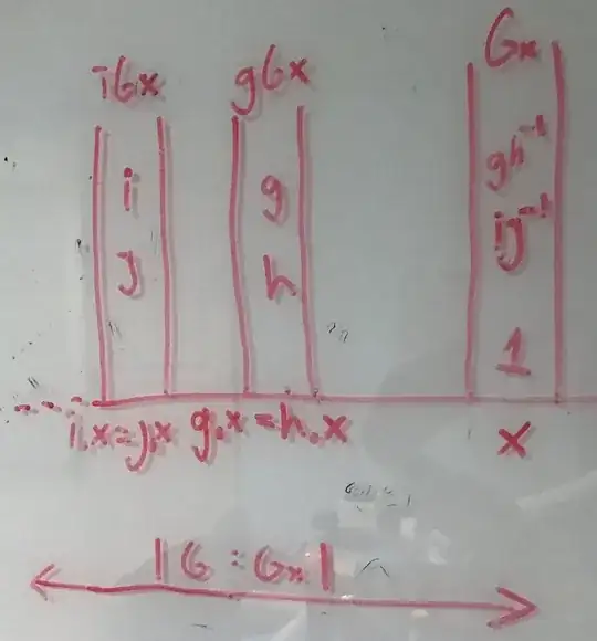

The statement of the theorem that I know says that if we partition $G$ into cosets of some $G_x,$ then we get an isomorphism of $G$-sets $G/G_x\to O(x),aG_x\mapsto a\cdot x.$
Here is my naïve way of thinking about it. Given a $G$-space $X$ and finite $G,$ the orbit-stabilizer theorem implies the "counting theorem" $|G_x||O(x)|=|G|.$ Since the size of $G$ is fixed, this is telling us that the larger the orbit is, the fewer elements of $G$ can possibly fix $x,$ while the smaller the orbit is, the more elements of $G$ must fix $x.$ This seems pretty intuitive, but it's not obvious. For example, we might think it possible that $|O(x)|$ is small, while many elements of $G$ act nontrivially but in the same way on $x.$ The orbit-stabilizer theorem disallows this, letting us determine the size of the stabilizer from the size of the corresponding orbit, and vice-versa.
Shaun
  • 44,997
Andrew
  • 11,179
