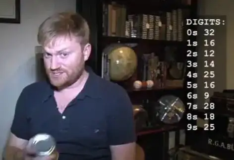

I guess that proof should be done in general, but here are the specific digits of the problem:
I'm just going to assume no available computer will be able to compute that absurd power, but I'd be interested in some of its characteristics nevertheless.

In conclusion, the number that you are looking I think is 2^2^2^2^2^2^ ... 3^3^3^3^3^3^ ... 10^10^10^10^ ... 90^90^90^90 ($12$ $2$s followed by $14$ $3$s, $25$ $4$s, $16$ $5$s, $9$ $6$s, $28$ $7$s, $18$ $8$s, $9$ $9$s, $16$ $10$s and $16$ $90$s).
