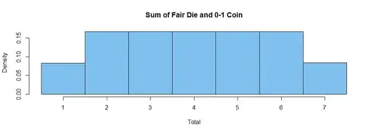

I doubt there is a really simple and useful answer to your question. But it's fun to speculate. Here is an approach using means and variances that might sometimes be easy enough to use.
If $X$ is the first random variable and $Y$ is a second one, then $E(X+Y) = E(X) + E(Y).$ So if you know the mean of the first random variable is $3.5$ and the mean of the second is $0.5$ then the mean of the sum is $4.$
The next part is harder, but sometimes useful. (Especially for normal random variables, but I know you asked about discrete ones.)
If the random variables are independent, then $Var(X+Y) = Var(X)+Var(Y).$ Then if you also knew that the variance of the first is about 2.9 and the variance of the second is about .25, then the variance of the sum is about 3.15, and the SD of the sum is about 1.8.
Finally, you might use the Empirical Rule to guess very roughly that about 95% of the values of the sum are within $4 \pm 3.6.$
Note: For a roll of a die and toss of a coin, quantiles .025 and .975 of the total are 1 and 7, respectively. The graph is from a very simple simulation. I sometimes use simulations to visualize probability results.
