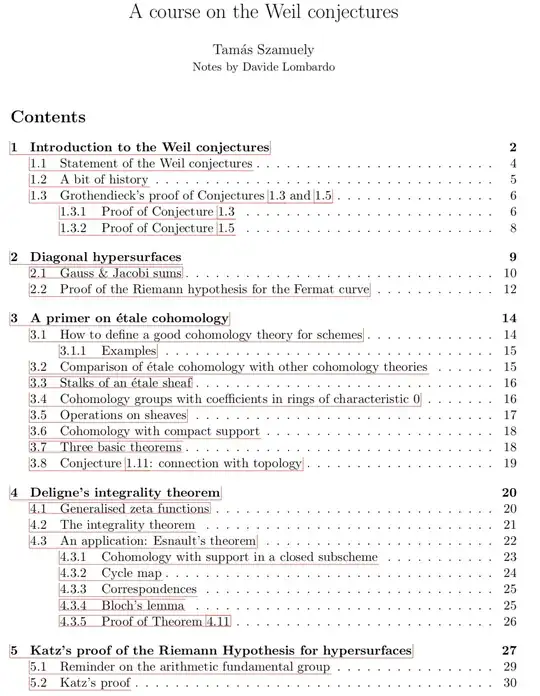

Edit (2020 July 27): Check out the AMS Open Math Notes on the Weil Conjectures here. The PDF can be downloaded without signing in or even having an AMS membership.

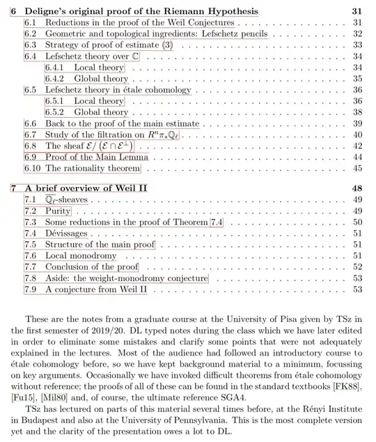

Pasting an image of the Contents from the start of the above-mentioned notes:
