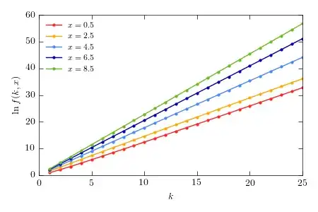

I calculate the results for $x = 0.1$ to $10$ and $k$ up to $25$ enter image description here
$\ln f( x, k )$ vs $k$ is pretty much on the straight line even for $k$ of order $10$.

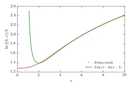

Then I fit the curve (in range $k \in [15, 25]$) and compare the slope with the result from @ThomasAndrews
Based on this finite size numerical calculation, we can see that for $x> 4$, $2\ln x - \ln( x- 1)$ is a very accurate estimation. It is actually the exact answer( see the error estimation by @ThomasAndrews ).
However, the error term can not be improved, because the data in range $[2,4]$ is slightly above $2\ln x - \ln( x- 1)$. The estimation doesn't work for $k < 2$.

I'm not sure why the fitting result is a bit off the theoretical line in $[2,4]$.
