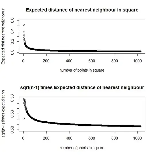

Empirically it is between $\dfrac{0.5}{\sqrt{n-1}}$ and $\dfrac{0.56}{\sqrt{n-1}}$, tending towards the lower bound as $n$ increases. This is not very different to putting $n-1$ random points in a circle or square with area $1$ and finding the expected minimum distance to the centre.
At the bottom end with $n=2$, the question becomes the expected Euclidean distance between two random points in a square, which an earlier answer gives as $\frac{1}{15}(2+\sqrt{2}+5\log(1+\sqrt{2})) \approx 0.5214$
Simulation results look like this, both directly and multiplying by $\sqrt{n-1}$
with values of

(See comments) The simulation code was
set.seed(1)          # to reproduce
maxn <- 1024         # top number for n-1 neighbours
cases <- 10^6        # simulations
x0 <- runif(cases)   # base points
y0 <- runif(cases)
mindistsq <- rep(Inf, cases)
emindist <- numeric(maxn)
for (i in 1:maxn){
  x <- runif(cases)  # possible neighbour
  y <- runif(cases)
  distsq <- (x0-x)^2 + (y0-y)^2
  mindistsq <- ifelse(distsq < mindistsq, distsq, mindistsq)
  emindist[i] <- mean(sqrt(mindistsq))
emindistsqrtn1 <- emindist * sqrt(1:maxn)   # multiplying by sqrt(n-1)
par(mfrow=c(2,1))
plot(2:(maxn+1), emindist, xlab="number of points in square",
                     main="Expected distance of nearest neighbour in square",
                     ylab="Expected dist nearest neighbour",
               ylim = c(0,0.6))
plot(2:(maxn+1), emindistsqrtn1 , xlab="number of points in square",
               ylab="sqrt(n-1) times expct dist nn",
               main="sqrt(n-1) times Expected distance of nearest neighbour",
               ylim = c(0.5,0.56))
par(mfrow=c(1,1))
exn1 <- c(1:9, 19, 49, 99, 199, 499, 999)
tab <- cbind(round(emindist[exn1],3), round(emindistsqrtn1[exn1],3))
colnames(tab) <- c("expected min","sqrt(n-1) times exp min")
rownames(tab) <- (exn1+1)
tab

  • So I guess these results are for a unit square ($m=1$). Did you use floating point numbers as the coordinates of the points? I suppose you used a pseudorandom number generator to get these coordinates. How many times did you calculate these values for each $n$? – Adam Sep 01 '17 at 12:59
  • @Adam. As you guessed, this is based on a unit square but you can just scale distances by the side of the square. I used R, which has double precision (so nearly 16 decimal digits), and I simulated $1$ million points with their nearest neighbours for each $n$. So I expect the rounded numbers in my table are accurate to $\pm0.001$ or better. I will add the simulation code – Henry Sep 01 '17 at 13:33
