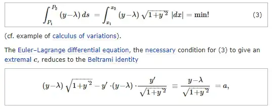

What surprised me is that according to this website, the Euler-lagrange equation looks very different:
There is not even a $y''(x)$ in their Euler-Lagrange equation. What am I doing wrong?

  • They have already integrated once. Your equations look right. Multiple through by sqrt term to simplify. You can then rejig it to look like $y'' f(y')=y'/(y-\lambda)$. This you can integrate. – user121049 Aug 30 '17 at 19:39
The clue is that your Lagrangian is independent of $x$. For any Lagrangian function $L\equiv L(\,y(x),y'(x)\,)$:
$$\frac{dL}{dx} \,=\, \frac{\partial L}{\partial y}\,y' + \frac{\partial L}{\partial y'} y'' \quad\Longrightarrow\quad \frac{\partial L}{\partial y}\,y' \,=\, \frac{dL}{dx} - \frac{\partial L}{\partial y'} y''. \qquad\qquad(*)$$
From the Euler-Lagrange equations:
$$\begin{aligned} \frac{\partial L}{\partial y} - \frac{d}{dx}\left(\frac{\partial L}{\partial y'}\right) \;=\; 0\quad&\Longrightarrow \quad y'\frac{\partial L}{\partial y} - y'\frac{d}{dx}\left(\frac{\partial L}{\partial y'}\right) \;=\; 0 \\[0.2cm] \quad&\Longrightarrow\quad \frac{dL}{dx} - \frac{\partial L}{\partial y'} y'' - y'\frac{d}{dx}\left(\frac{\partial L}{\partial y'}\right) \;=\; 0 \\[0.2cm] \quad&\Longrightarrow\quad \frac{dL}{dx} - \frac{d}{dx}\left[y'\frac{\partial L}{\partial y'}\right] \;=\; 0\\[0.2cm] \quad &\Longrightarrow\quad \frac{d}{dx}\left[ L - y'\frac{\partial L}{\partial y'}\right] \;=\; 0 \end{aligned}$$
where on the second line we substituted in $(*)$. Integrating this, as @user121049 already mentioned, gives you
$$L - y'\frac{\partial L}{\partial y'} \;=\; a$$
for some constant $a$. This is the Beltrami identity; you should be able to use this derivation to help with your problem.

  • Yes - you're right on both counts! The primes have been added as has $d\rightarrow\partial$, so thanks for the corrections. My math gets sloppy late at night! – AloneAndConfused Aug 31 '17 at 06:37
    I now understand it, thank you :) – user56834 Aug 31 '17 at 07:39
