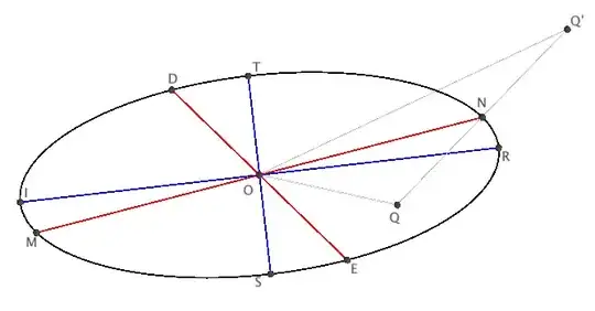

I don't know if this answer will be of help to you, nonetheless I would like to show a more geometric approach.
In diagram below, $A=(0,0,0)$ is the projection point, the yellow plane is the screen ($z=1$) while the circle (of center $G$) lies on the blue plane. The two planes meet at a certain line $r$ (dashed red) and let $BC$ be that diameter of the circle such that line $BC$ is perpendicular to $r$. Moreover, let $F$ be the intersection of line $BC$ with plane $z=0$.
If projection lines $AB$ and $AC$ meet the screen at $M$ and $N$, $MN$ is a diameter of the projected ellipse and its midpoint $O$ is thus the center of the ellipse. Its conjugate diameter $ED$ lies on the line through $O$ parallel to $r$, and $$ OD=OE=OM{\sqrt{BF\cdot CF}\over AF}. $$
Once you have two conjugate diameters, you can find the principal axes as follows (see diagram below). In the plane of the ellipse, draw line $QQ'$ through $N$ perpendicular to $DE$. Points $Q$ and $Q'$ must be chosen such that $NQ=NQ'=OD$. Principal axes $IR$ and $ST$ lie then on the bisectors of the angles formed by lines $OQ$ and $OQ'$, and: $$ IR=OQ'+OQ,\quad TS=OQ'-OQ. $$

  • A beautiful and simple geometric solution. Much nicer than the intersection of cone and plane that I’d been considering. – amd Aug 31 '17 at 22:54
  • @amd The first construction is based on Apollonius' Conica, Prop. I-13, the second one on Problem 62 in "Constructive Geometry" by Eagles. – Intelligenti pauca Sep 01 '17 at 07:20
  • Actually this answer helps me the most, as I wanted to be able to visualize and construct projected circles with a ruler and a compass. I attempted to compute the the angle algebraically first as I'm a bit more comfortable with that. But very nicely done. – Lærne Sep 04 '17 at 09:42
