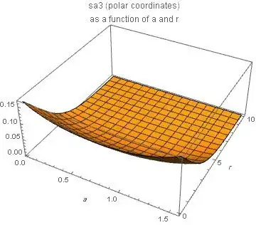

Now we make two subsequent coordinate transformations
  1. x-> Exp[-u], y->Exp[-v]
  2. u->r Cos[a], v-> r Sin[a], 0<=r, 0<=a<=pi/2
This defines sa3. Instead of giving the lengthy expression we show the plot
The plot shows that sa3 is a pretty innocent function.
$-f$ is now given by the integral of $sa3$ over $r$ from $0$ to $\infty$ and over $a$ from $0$ to $\pi/2$.
A numerical check gives sufficient agreement between direct sum with 10^4 terms (|sum| = 0.392733) and this integral (int =0.392733 ) to see that the integrand is correct.
Expansion of the integrand in a series of powers of $(a-\pi/4)$
I was not able to do the integral in symbolic form (neither of the two). The plot shows, however, that the dependence of the integrand on $a$ is weak so that it seems reasonable to expand the integrand in a series of (even) powers of $(a-\pi/4)$ the coefficients of which are integrals over $r$ which seem not impossible to be done in closed form.
The first term of this development (equal to $sa3$ for $a = \pi/4$) is
$$sa3(a=\pi/4)= \frac{\left(\sqrt{2} e^{\frac{r}{\sqrt{2}}} r+\sqrt{2} r-4 e^{\frac{r}{\sqrt{2}}}+4\right) \left(5 \sqrt{2} e^{\frac{r}{\sqrt{2}}} r+\sqrt{2} r-4 e^{\frac{r}{\sqrt{2}}}+4\right)}{8 \left(e^{\frac{r}{\sqrt{2}}}-1\right)^2 \left(e^{\sqrt{2} r}-1\right) r}$$
Mathematica refused to solve that integral.
