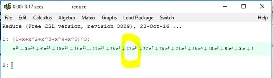

There's a special trick that can be applied here: $a_{n}=3a_{n-1}-3a_{n-2}+a_{n-3}$ is known to be a quadratic polynomial in $n$. So, when $n$ is not a multiple of $6$, you get that:
$$a_{n-2}-a_{n-3},a_{n-1}-a_{n-2},a_{n}-a_{n-1}$$ must be an arithmetic progression for any $n$ not a multiple of $6$.
So we have that $a_5-a_4 = 6, a_6-a_5=4$ and thus $a_7-a_6=2$, or $a_7=a_6+2=27.$ $a_8=27+0=27, a_9=27-2=25,a_{10}=25-4=21,a_{11}=21-6=15,a_{12}=15-8+(-1)^2\binom{3}{2}=10$.
