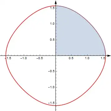

Visualization of region (cos x + cos y > 1) and |x| < pi/2 and |y| < pi/2, by Wolfram Alpha

Write the implicit equation into parametric form: $$\begin{cases} x(t)=t\\ y(t)=\pm\arccos(1-\cos t) \end{cases}\quad t\in [-\dfrac{\pi}2,\dfrac{\pi}2]\tag{1}$$
The curve looks like:
Use Green's theorem,
$${\rm Area}=4\int_0^{\tfrac{\pi}2}x(t){\rm d}y(t)=4\int_0^{\tfrac{\pi}2}\dfrac{-t \;\sin t\; {\rm d}t}{\sqrt{(2-\cos t) \cos t}}\tag{2}$$
